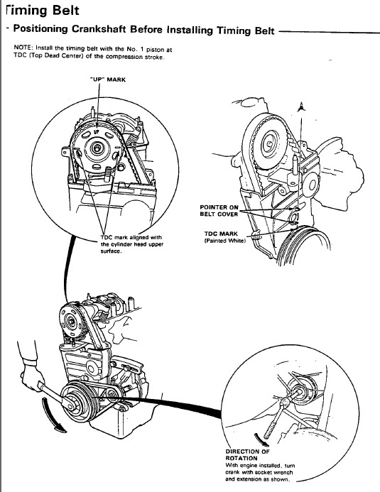

Timing belt
Diagram 1 below shows how to synchronize the camshaft and crankshaft at Top Dead Center (TDC) for installation of the timing belt. I expect that if you haven't ever done a job of this difficulty level then you will likely need more than 2 hours. The most difficult step is removal of the crankshaft pulley bolt. You'll need either a very good impact wrench or a special Honda hex tool and two long breaker bars. Get the 88 Civic service manual (see link in my signature) and read the timing belt section carefully.

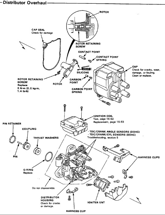

Distributor
Yes, the distributor has an O-ring (see diagram 2). See manual for more details.

Before taking the old belt off, turn the engine so the marks on the cam pulley line up and "UP" on the cam pulley is up. This is TDC1. Put the new belt on and double check the marks on the cam pulley as well as the crank. Note that with the big accessory pulley off, you align to the little dot on one of the crank pulley teeth, not the keyway.
