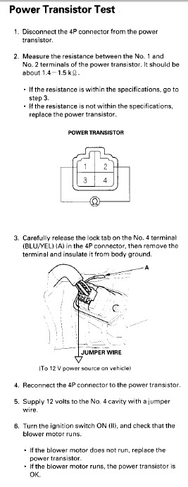

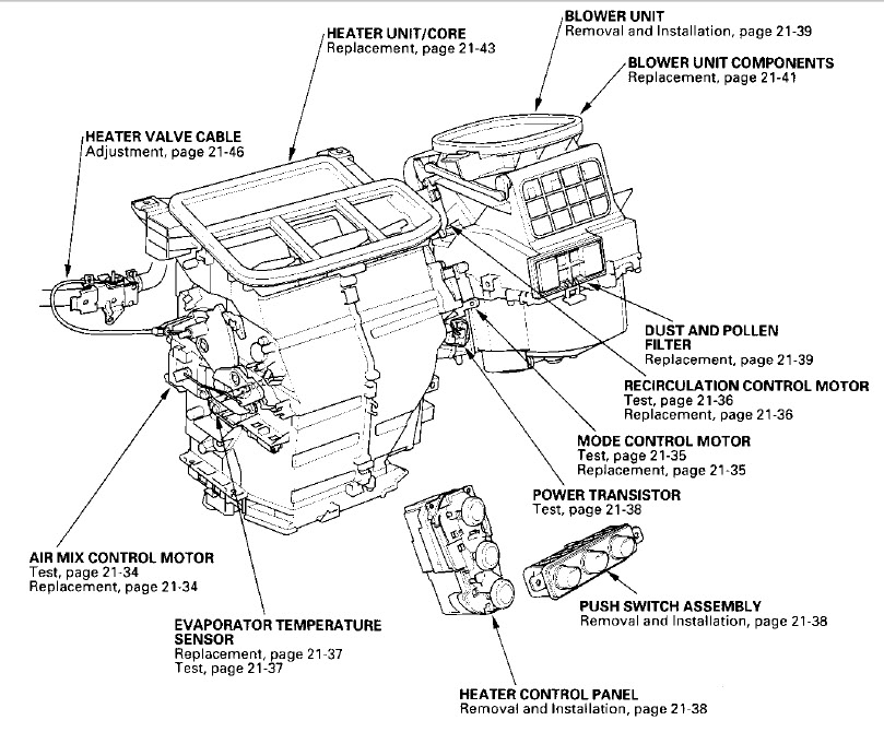

The resistor pack (on older models) on the blower motor can burn out some resistors and leave you with only the highest speed on the blower motor. you will need to replace just the resistor pack though in this case, it looks like you have a power transistor and no resistor pack at all.
At least through the diagnostic test posted by RonJ, you should know right away if the power transistor is good or not.
It looks like you did some good troubleshooting to demonstrate the fact that the blower motor is functioning properly. that's a great job.
