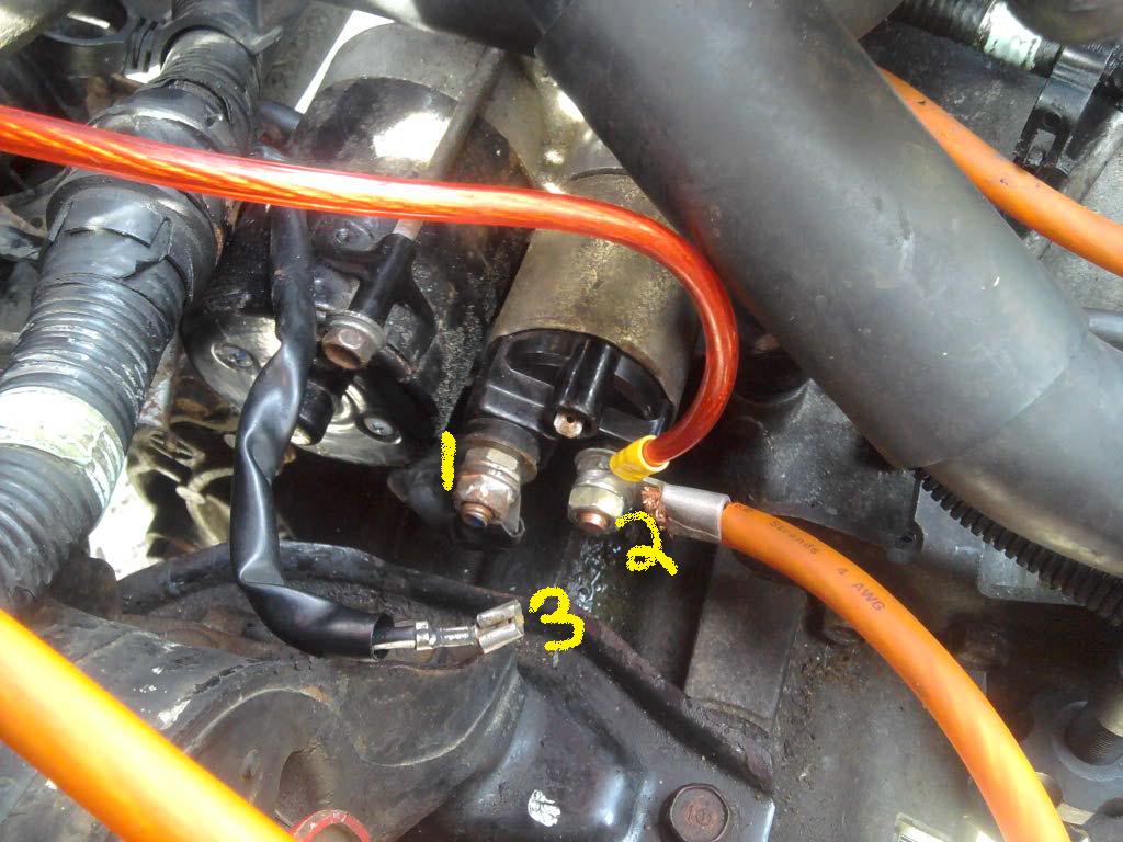

ok here is a picture so i can get some help...
ok bolt 1 is the ground to the starter. bolt 2 is the positive to starter. and i believe wire three is the wire that says hey starter turn on. i have 12.18 volts from positive on the battery to negitive on the battery. i have 11.56 volts from bolt 1 to bolt 2. i have 11.55 volts from the wire three to big bolt 2. by the way my keys are not on or in the start position. they are not even in the ignition. and from what i know about electronics. the 11.55 volts from the wire to the positive is telling the motor to spin. now its not hooked up so its not spinning, because when it was hooked up it would not spin it would just get super super super hot. so yea. am i doing everything right or am i an idiot. and i think this is the perfect time to get a push to start button =)

like u said mk helped. just to recap what he said just in case anyone is to stumble on this with the same problem. the positive goes on post 1. the negative on post 2. i had them flipped. which the positive hooked up to the ground caused the starter to get very hot very quick. but i flipped it and the car now cranks fine, doesn't start, or run, or drive. but it cranks. i have to fix a small gas leak. might just be some new washers or something, its right at the end of the fuel filter where the hose goes to the throttle body. maybe i never torqued it down enough. then the car should start. i need to re flush coolant and maybe change the oil. and do some work on the air intake. then it will run. put new brakes and springs on. new windshield, new head lights, new exhaust, then it will drive. there's a ton more ill list here... hopefully nothing else big pops up...
