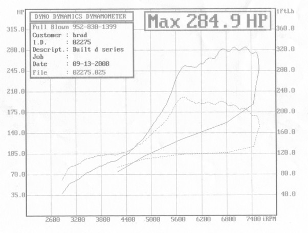

#270
cost of tune, all the parts, and everything $1300, on the plus side, my bov sounds cool!
car was on dyno 6 hours!!!
issues we came upon:::
1.) spark plug gapping wouldnt let us get over 245whp
2.) my bbk throttle body wouldnt read my tps sensor so i have no 1/4 (omg so annoying)
3.) my godspeed intercooler was very restrictive, would not give me any more power over 15psi, we had it at 20 and it gave the same power as 15, """dont buy a godspeed intercooler unless you aernt looking for a lot of power""""
4.) phearable gave me a defaulty boost controller, it didnt work! we had to tune it with a manuel. that *** clown
5.) the dyno and my car wouldnt read my rpm the same screwing everything up on the dyno pulls.
6.) my car says its near overheating, but when we shoot it with a temp sensor it reads right at optimum, which scared LJ for a while lol
7.) my friends kept making fun of me for driving a honda (the worst part)
8.) the supra next to me making 800whp made me sad (2nd worst part)
so... we are planning a re-tune as soon as i get a new throttle body, phearable fixes my ecu, and i get a better flowing intercooler... LJ said my intercooler is making my turbo act like a t25 at high boost, its flowing 18 lbs, but its not at the same volume as a t3/t4 so it SUCKS!
heres my sheet, sorry its not as good as it should be... add 6% for a dynojet, so on a dynojet its making 302whp and just over 205wtq
sheets in attachment, im kind of embarrassed of it
p.s. if you look at my curve, at 5700 rpm it really starts acting up, when i fix the issue on 15 psi follow that curve to 7k, should be around 300+ on 15 psi lol
